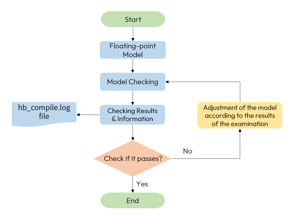

In engineering practice, since not all floating-point models can be converted to quantized models, checking is required before conversion. This checking process will go through the process of a model conversion, the basic flow of its operation is shown below:
model_checking
However, for those more time-consuming procedures, we simplified the checking process. This command will output the check results and the OP deployment on the device when it finishes the checking of the model.
