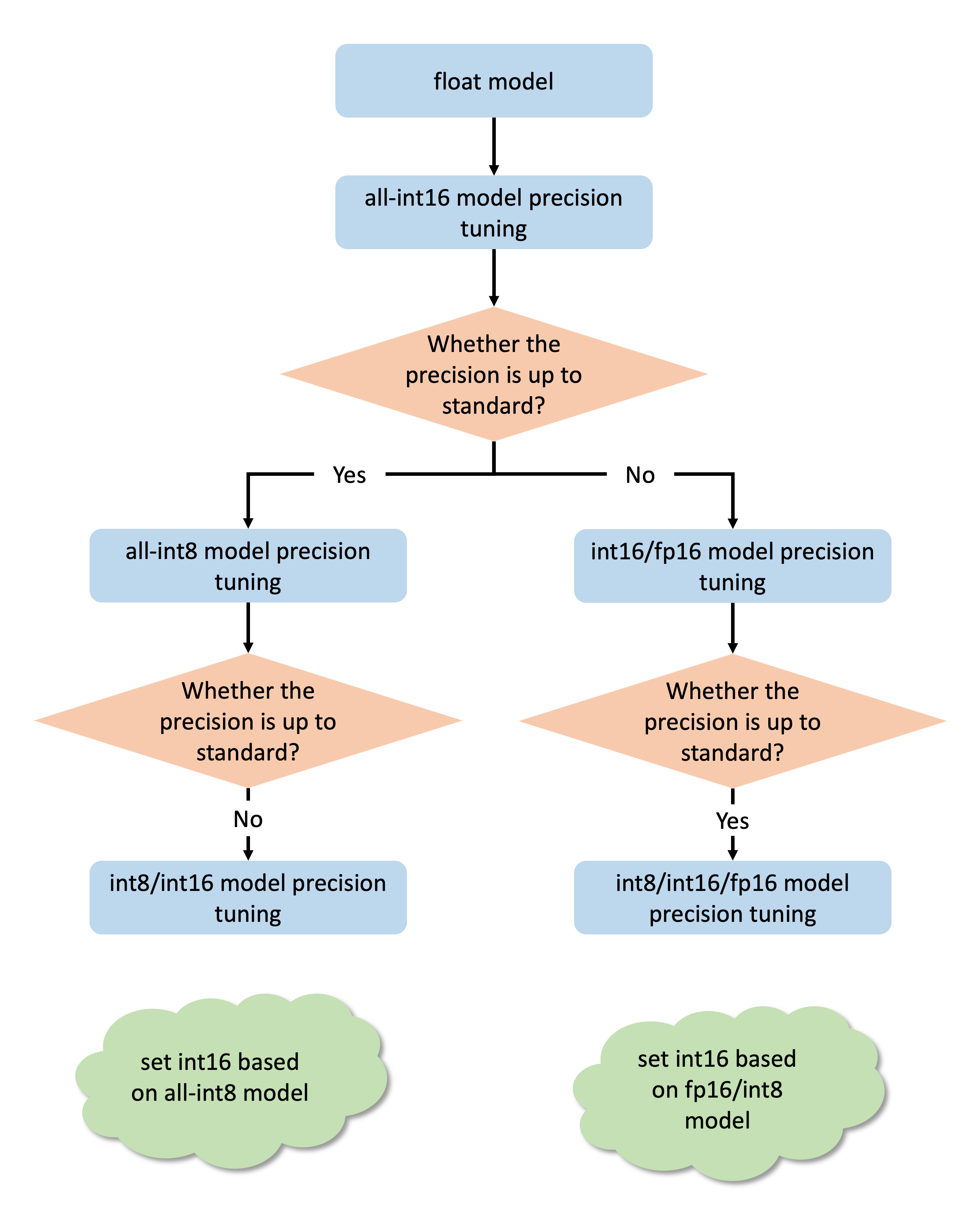

Tuning Pipeline
tuning_pipeline
The entire pipeline first involves all-int16 accuracy tuning to confirm the model's upper bound of accuracy and check for tool usage issues or quantization-unfriendly modules.
  1. After confirming that all-int16 accuracy meets the requirements, perform all-int8 accuracy tuning. If the accuracy is not good enough, perform int8/int16 mixed precision tuning. Starting with an all-int8 model, gradually increase the proportion of int16 operators, balancing accuracy and performance.
  2. If all-int16 accuracy does not meet the requirements, perform int16/fp16 mixed precision tuning. Ideally, int16/fp16 mixed precision tuning can solve all accuracy problems. Based on this, perform int8/int16/fp16 mixed precision tuning, fixing all fp16 operator configurations, and adjust the proportion of int16 operators as described in step 1.

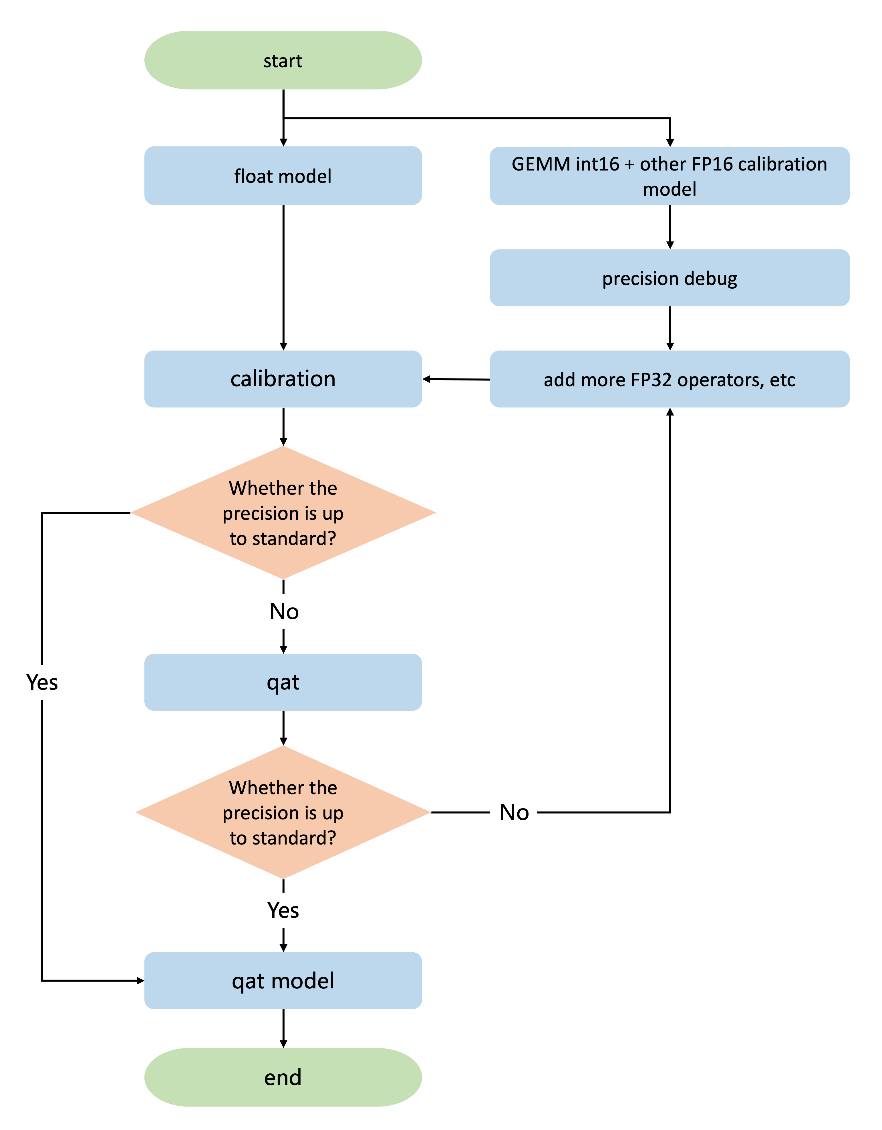

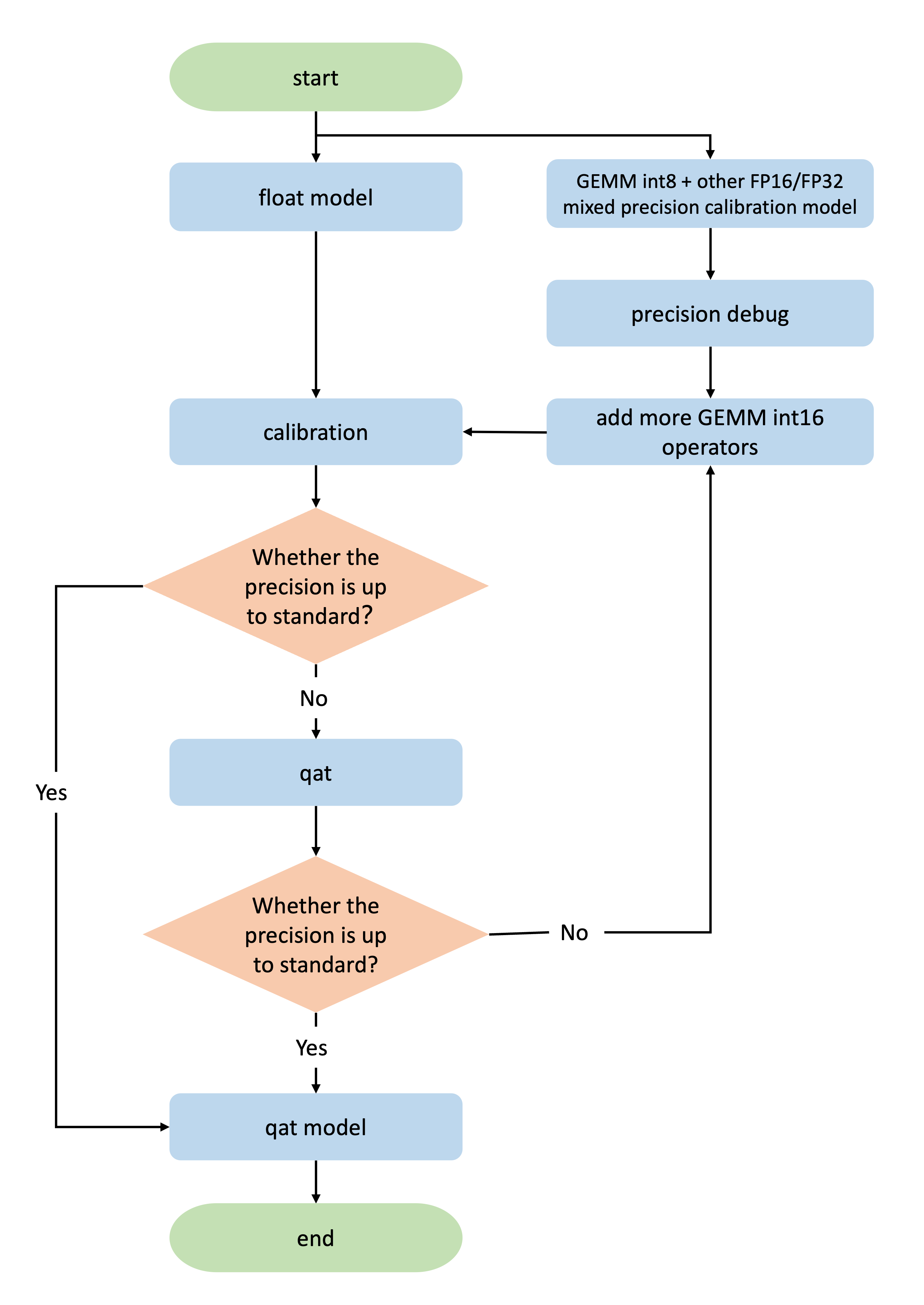

INT8/INT16 & INT16/FP16 Mixed Precision Tuning
The basic idea of mixed precision tuning is to incrementally introduce higher precision operators into a lower precision model until the desired accuracy is achieved. For int8/int16 tuning, start with an all-int8 model and incrementally increase the number of int16 operators. For int16/FP16 tuning, start with an all-int16 model and incrementally increase the number of FP16 operators.
mixed_precision_tuning_int8_int16
The calibration and QAT tuning in the figure above can reference both Basic Tuning Methods and Advanced Tuning Methods sections. Increasing the number of high-precision operators for int16/fp16 relies on a series of debug results produced by accuracy debugging tools.

Tuning Pipeline
j6p_tuning_pipeline
Similar to the S100/S100P mixed-precision tuning process, the S600 mixed-precision tuning process also starts with a relatively high-precision configuration. We recommend starting mixed-precision tuning with the gemm operator input set to double int16 and other operators set to FP16.
  1. After confirming that the gemm operator input set to double int16 and other operators set to FP16 meets the accuracy requirements, maintain FP16 for other operators and perform mixed-precision tuning for the gemm operator input set to int8. If the accuracy is not satisfactory, perform mixed-precision tuning for the gemm operator input set to int8/int16, gradually increasing the proportion of int16 from all int8. During this stage, you need to balance accuracy and performance, finding the quantization configuration that maximizes performance while maintaining accuracy.
  2. If the precision of the gemm operator input double int16 and other operators FP16 does not meet the requirements, maintain the gemm operator input at double int16 and perform targeted processing on non-gemm operators. The processing method is described below. Then, optimize the gemm operator input to int8 precision, fix the FP16 precision of other operators and the configuration of targeted processing, and adjust the gemm operator input ratio to int16 using the int8/int16 mixed precision tuning method in 1.
gemm input double int16 + other FP16 Tuning
mixed_precision_tuning_gemmint16_otherfp16
QconfigSetter is configured as follows:

gemm input int8/int16 + other FP16 Tuning
Before performing mixed-precision tuning for gemm inputs with int8/int16 and other operators with FP16, you should have completed mixed-precision tuning for gemm inputs with double int16 and other operators with FP16. Reuse the qualified configuration or modifications from the gemm input configuration with double int16 and other operators with FP16, and perform precision tuning on the gemm input configuration with int8 and other operators with FP16. Refer to the precision tuning method in the previous section and continuously adjust the int16 ratio of gemm operators until you find the minimum int16 ratio that meets the precision requirements.
mixed_precision_tuning_gemmint8_otherfp16fp32
from horizon_plugin_pytorch.quantization import prepare, PrepareMethod, get_qconfig from horizon_plugin_pytorch.quantization.qconfig_setter import * setter = QconfigSetter( reference_qconfig=get_qconfig(), templates=[ ModuleNameTemplate({"": torch.float16}), # all ops float16 output ConvDtypeTemplate(input_dtype=qint8, weight_dtype=qint8), # conv input and weight both int8 MatmulDtypeTemplate(input_dtypes=qint8), # matmul two inputs int8 SensitivityTemplate( # If the high-sensitivity feat or weight is configured as int8, change it to int16 sensitive_table=..., topk_or_ratio=..., ), ], ) qat_model = prepare( model, example_inputs=example_inputs, qconfig_setter=setter, method=PrepareMethod.JIT_STRIP, )
