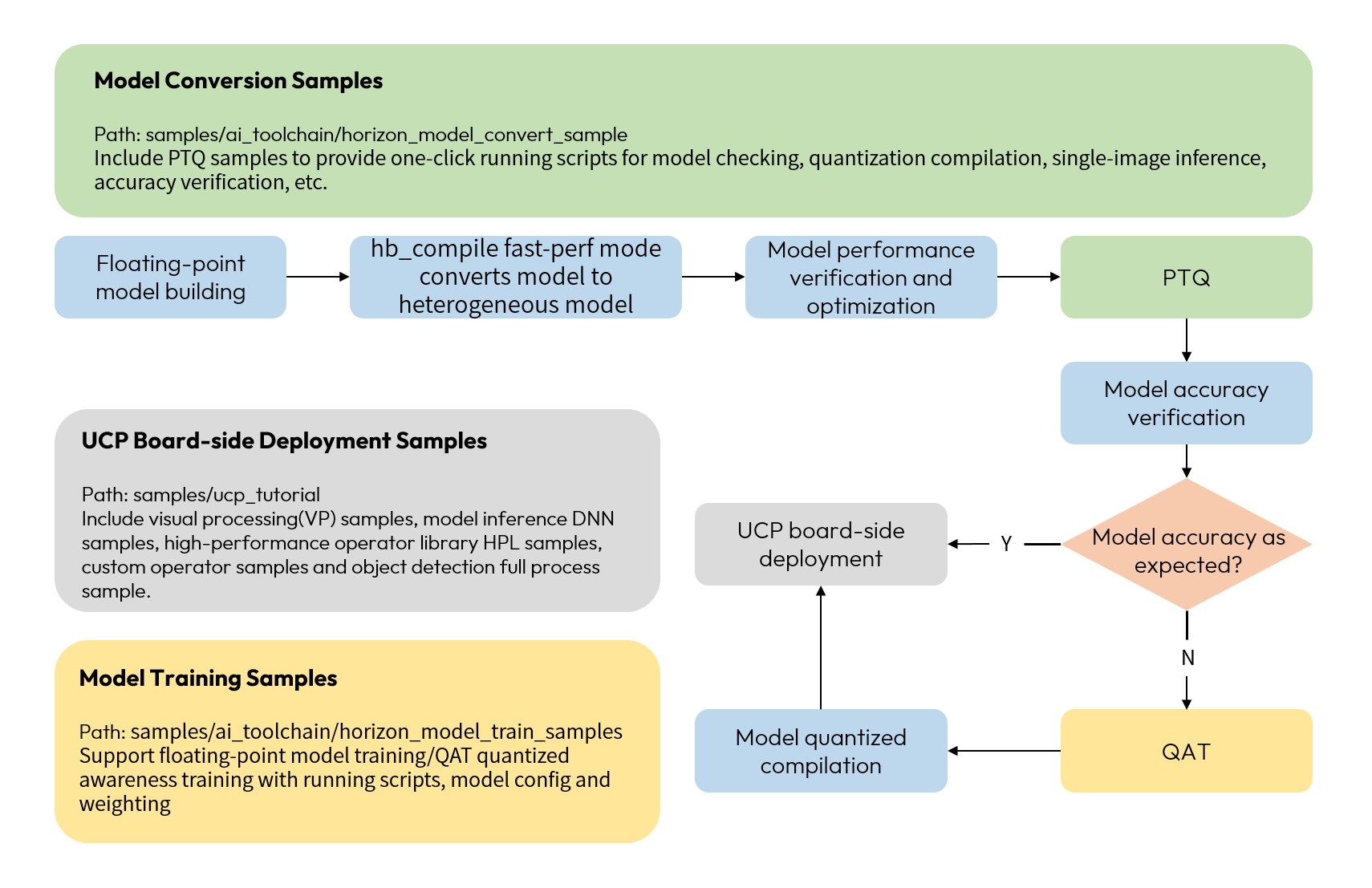

The samples directory provides model training sample, floating-point to fixed-point model sample, and UCP related sample in the Unify Compute Platform. Below is a distribution of general processes and samples used at each stage of the toolchain:
oe_package_sample
The samples correspond to different stages of use in the flow of the toolchain shown above:
  • The model conversion sample contains the processes of model checking, calibration data processing, model quantization compilation, single image inference, and accuracy evaluation in the model PTQ conversion phase.
  • The model training sample contains dataset packing scripts, model config files, training scripts, and other tool scripts for the floating-point model training (optional) and QAT quantization training (optional) phases, so that the QAT quantization training strategy can be attempted when the expected accuracy is not achieved by applying model accuracy optimization tools.
  • UCP board-side deployment samples, including visual processing, model inference, high-performance operator library, custom operator and object detection full process sample. The model inference sample provides compilation scripts, run scripts and source code for the model deployment stage.
