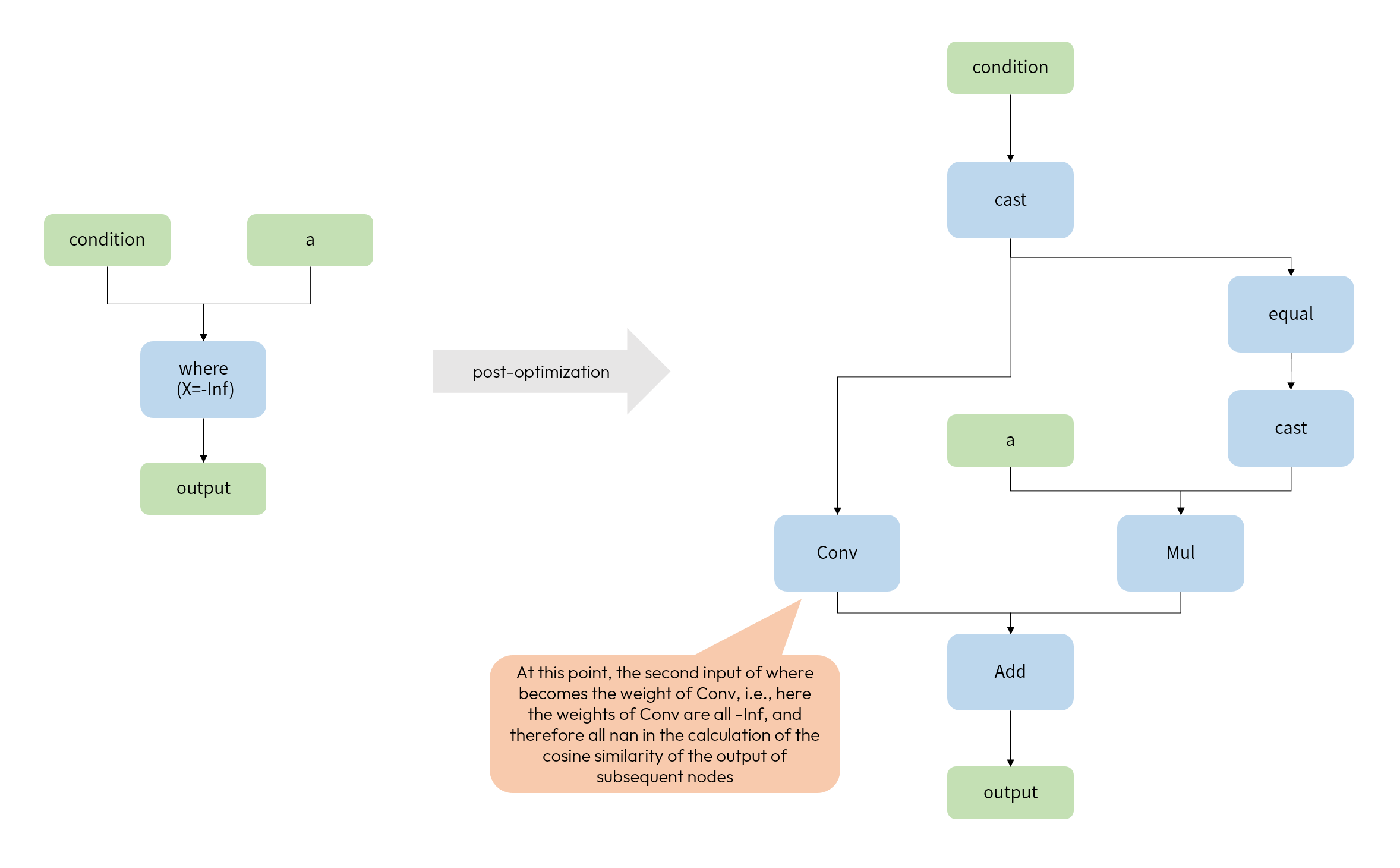

In the conversion process, what are the several scenarios in which the Calibrated Cosine column appears as nan in the print log of the hb_compile tool and what causes such problems?
Case 1: The second input to the where operator in the model is -Inf
During the optimization phase of the conversion process, in order to be able to ensure that the where operator can be quantized, this operator will be split into a combination of several quantizable operators during the optimization phase. When the second input of where is -Inf, there will be a case of nan in the conversion process. The reason is as follows:
where_operator

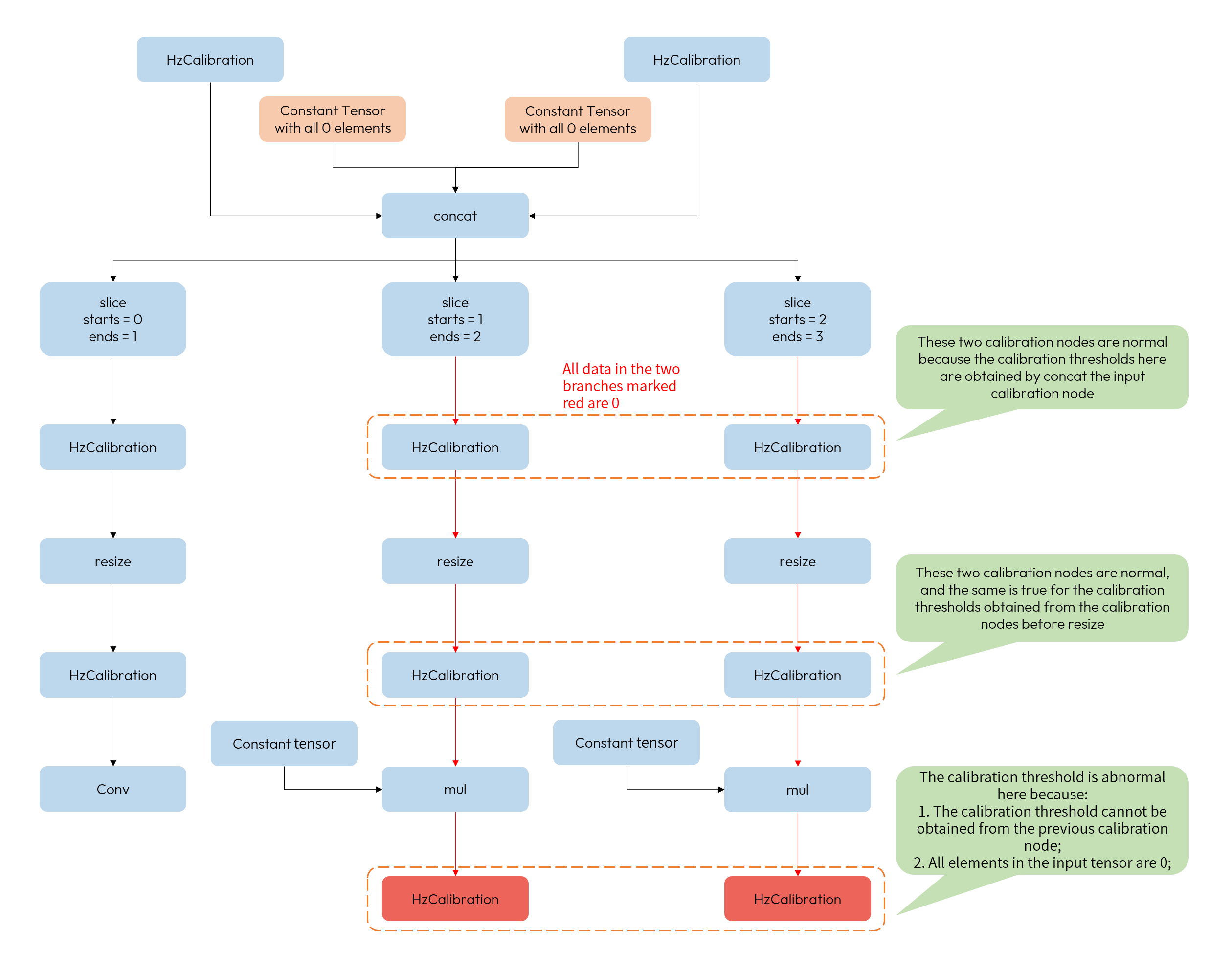

Case 2: All 0 tensor in the model
1). concat result in all 0 tensor.
Taking the above structure as an example, the two inputs to concat are all 0 constants, so it is possible that the subsequent output after slice may have a branch in which the data flowing are all 0, and lead to illegal thresholds (i.e., thresholds of 0) in HzCalibration.

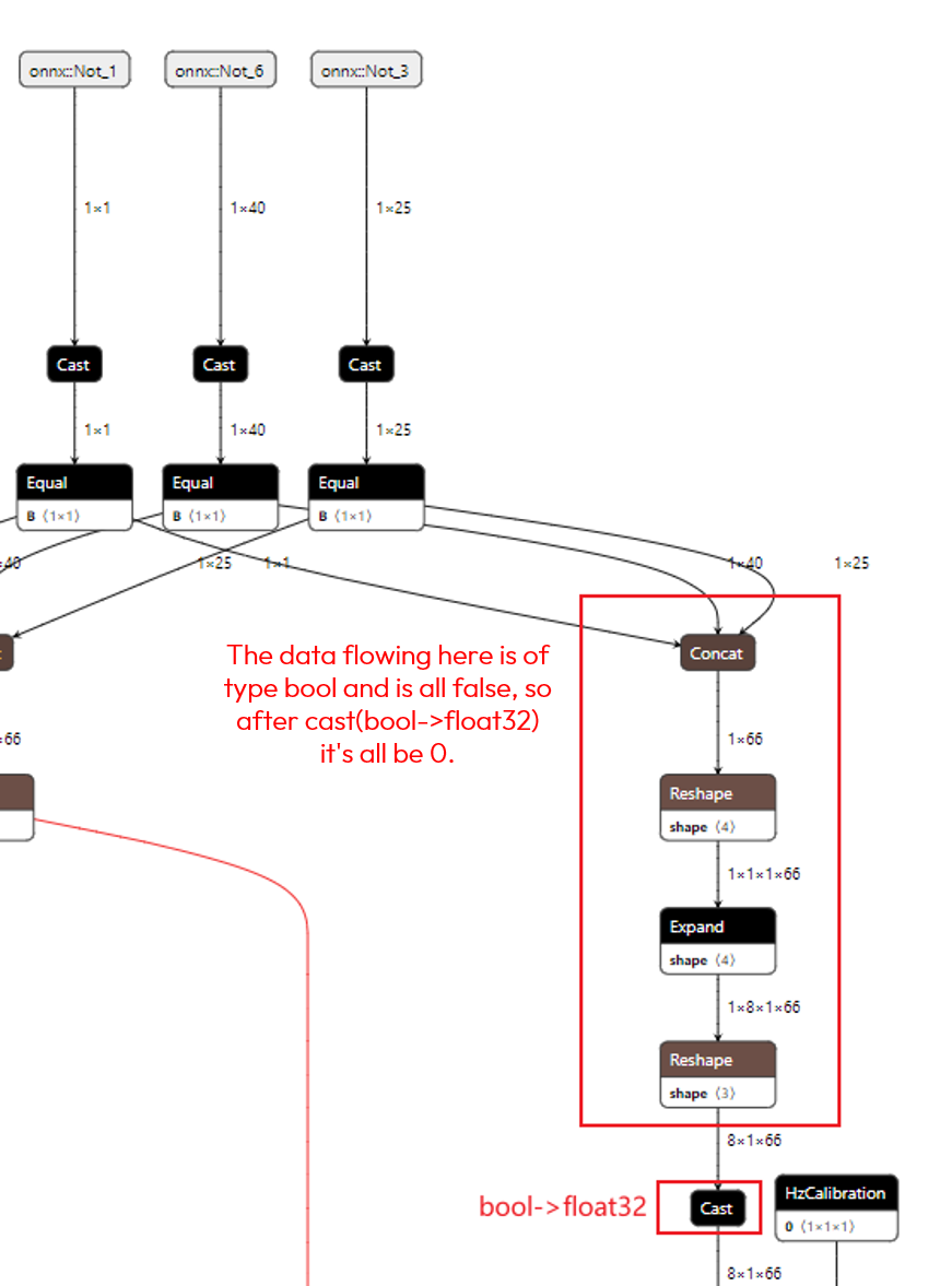

2). equal result in all 0 tensor.
equal_tensor
Taking the above structure as an example, the input onnx::Not_3 to the model is a bool type tensor, which after cast+equal results in all false data in the tensor, and after cast(bool -> float32) results in an all 0 tensor.
Warning
This case requires the customer to try to test with multiple sets of data, thus ruling out the possibility that the model has all 0 caused by the calibration data.
