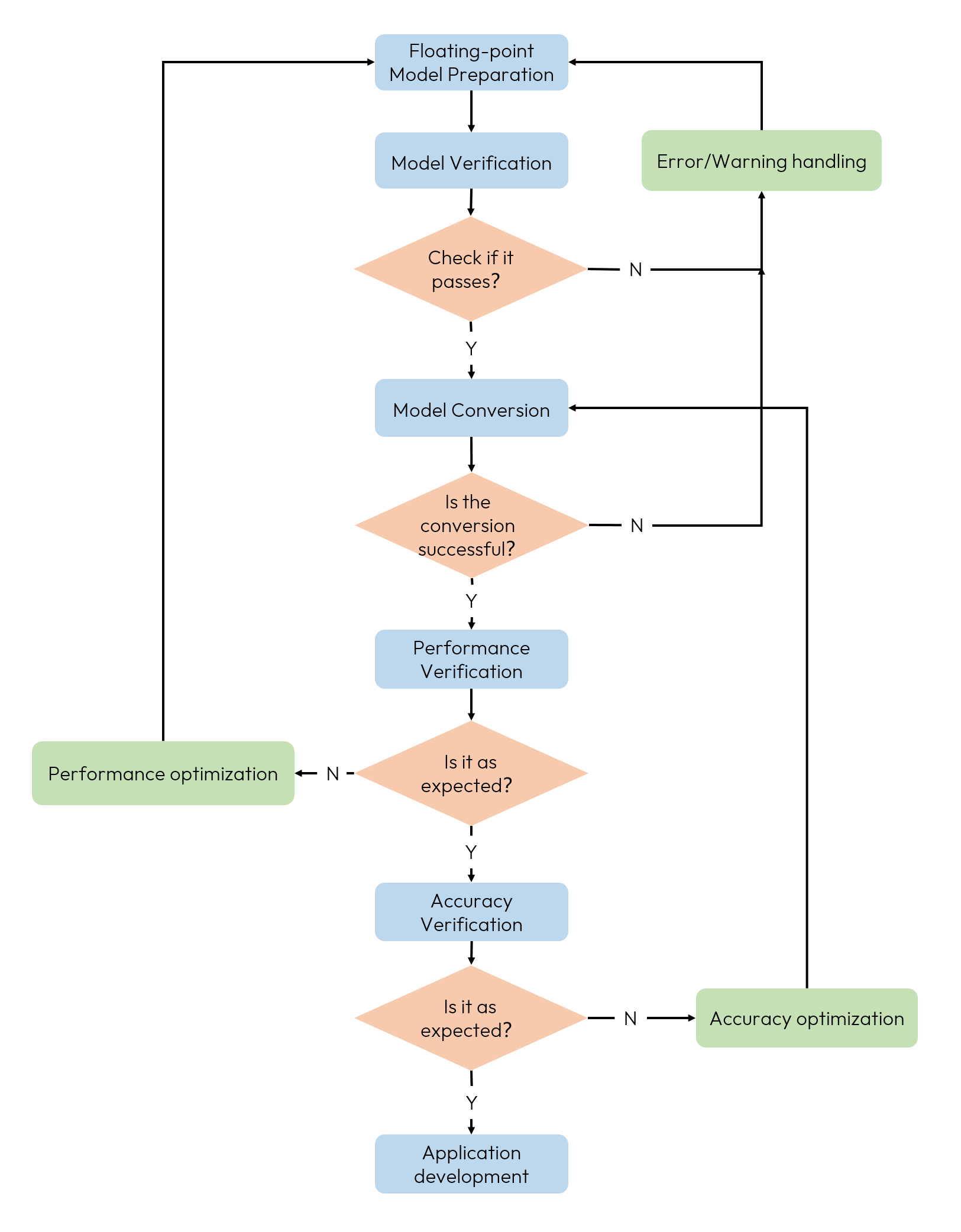

To help you quickly get started, this section introduces the basic workflow of the PTQ scheme using ResNet50 as an example to illustrate the details.
The basic workflow is as follows:
